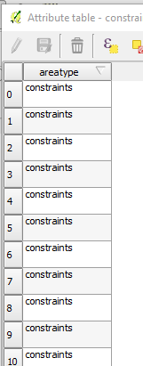

  2. In the attribute table, clear all columns and create a new column called ‘areatype’ and fill the value as ‘constraints’
