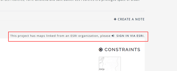

Your project needs to be “linked to ESRI” to enable this functionality. You can do this during the time of project creation or contact the Geodesignhub support if you want to link your existing project. You can verify if your project is linked if you see the text below at the top of your page “This project has maps linked from an ESRI organization”
Sign in to ESRI ArcGIS Online
At the top of your Geodesignhub project, you will see a link to sign in to ESRI as shown below

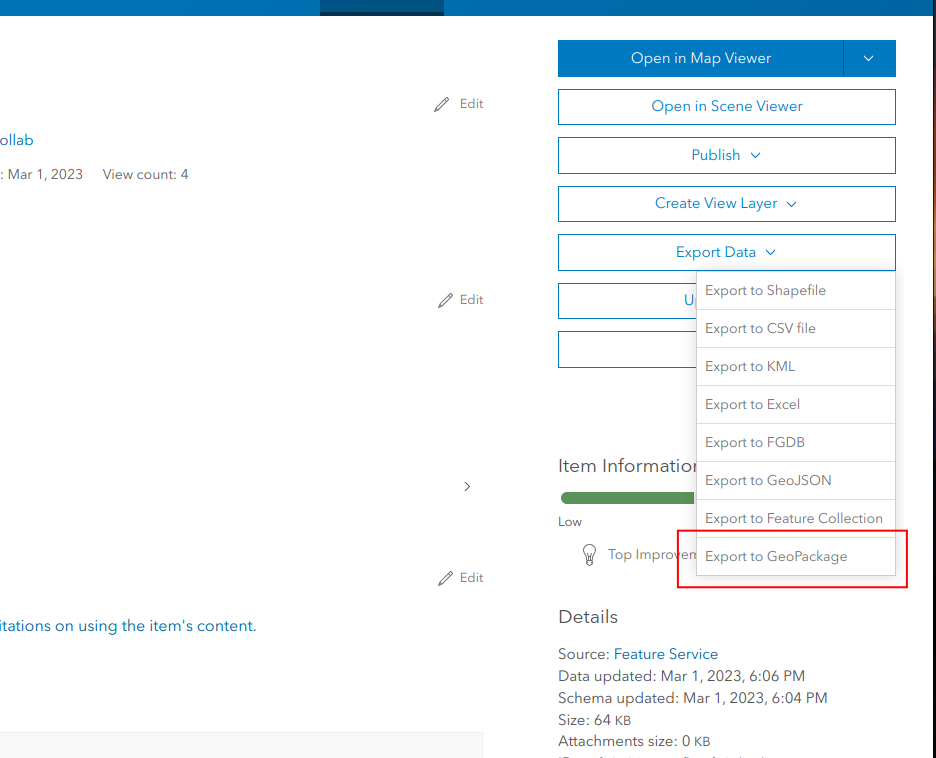

Step 1: Select the data source e.g. Hosted Feature Layer that you want to export in AGOL, this can be any data that you have in your content library and / or your organization’s content library. Select the “Export data” control in AGOL and select the “Export as GeoPackage” command

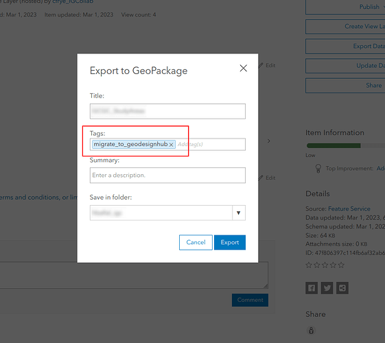

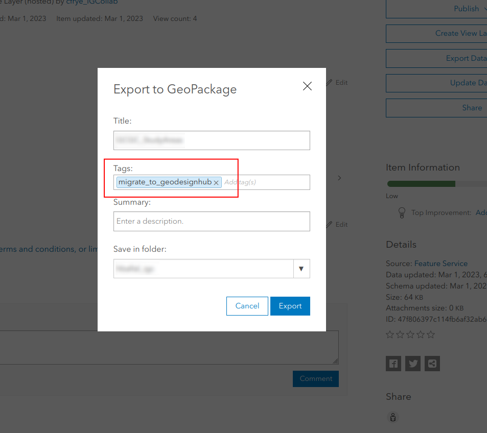

Step 2: A dialog like the one below is shown. You will need a tag called migrate_to_geodesignhub for your item, this is the way the bridge understands and lists the item for export.
Once this is complete your item will be available in your content library (not your organization’s library) to the bridge for export.

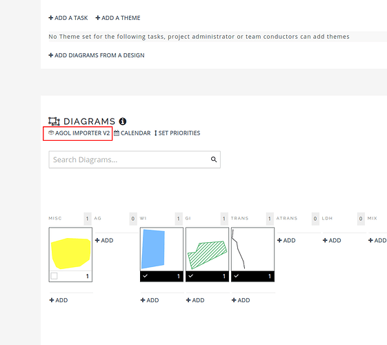

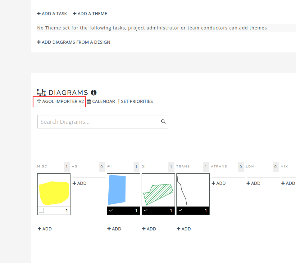

Once you enter your credentials, the pop-up window will disappear and you will be logged into the ESRI systems. You can now scroll down to the “All Diagrams” section of Geodesignhub

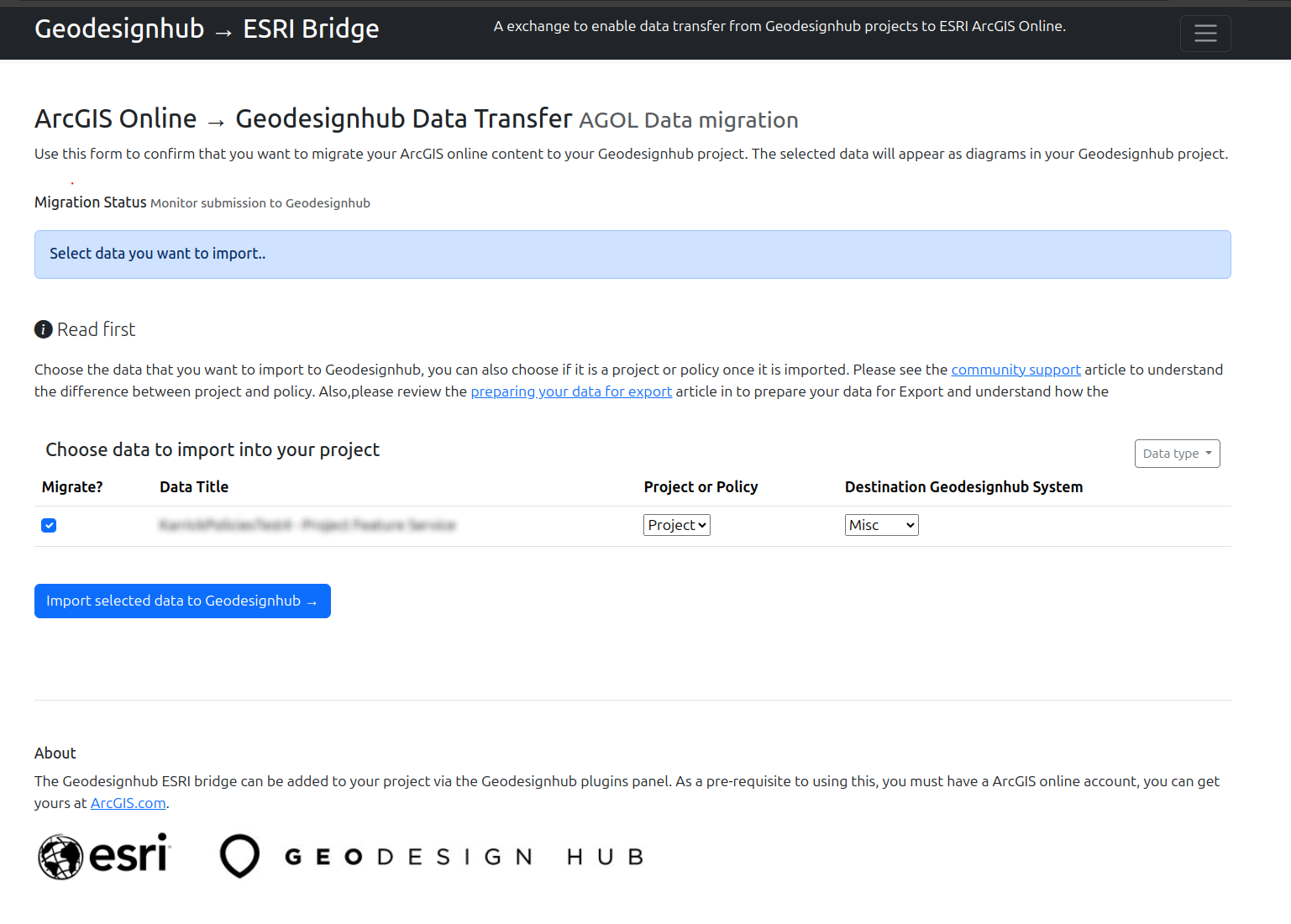

Import screen
Once you click the import data button, a new pop up will appear, you can confirm the items you want to import, the target Geodesignhub system and whether the imported data will be classified as a project or a policy.
This plugin will import your data from ArcGIS systems,to the Geodesignhub projects, it may take some time (40-60 seconds) to process your request and transfer the data.
